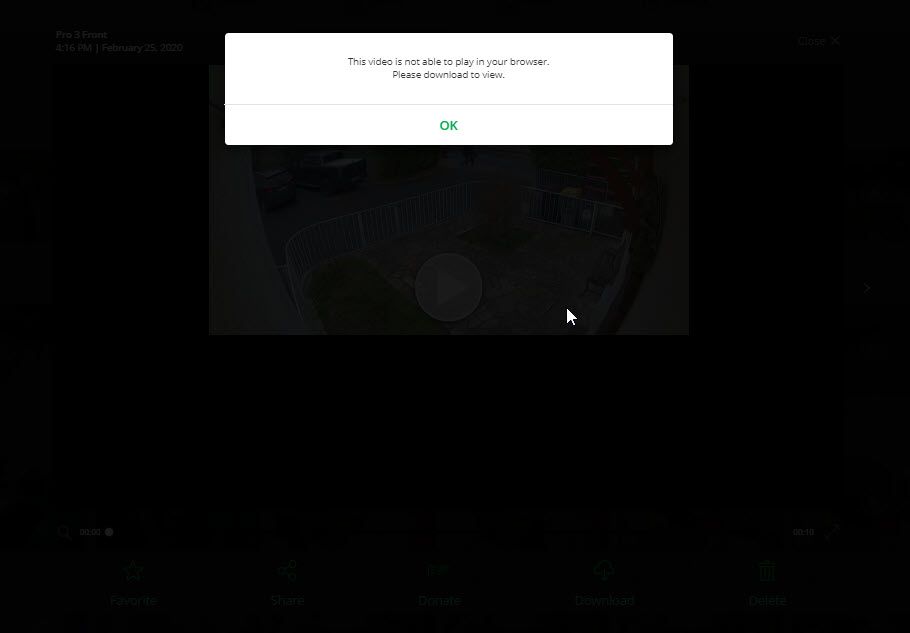

Getting the following error when trying to watch save motion-triggered videos in the Chrome browser:
This video is not able to play in your browser. Please Download to view.
When I download the video, it comes as an MP4 file but it plays with only sound. No video is showing.
I just upgraded Chrome to the newest version and the problem persists. Operating System: Windows10

Yep, just got the Arlo Pro 3 Cam today and get the same error within Chrome, bummer, this sucks!
No problem downloading and watching.
Is there any fix or work around to be bale to use Chrome for the web app interface and view pro 3 recordings?

Yep, I am getting the same error, bummer this sucks!
error pic link
Is there any fix or workaround to be able to view recording from the pro 3 within chrome?

To play the recording your browser must support HEVC playback. Take a look here for more information: Which devices are supported for HEVC 4K or 2K playback?

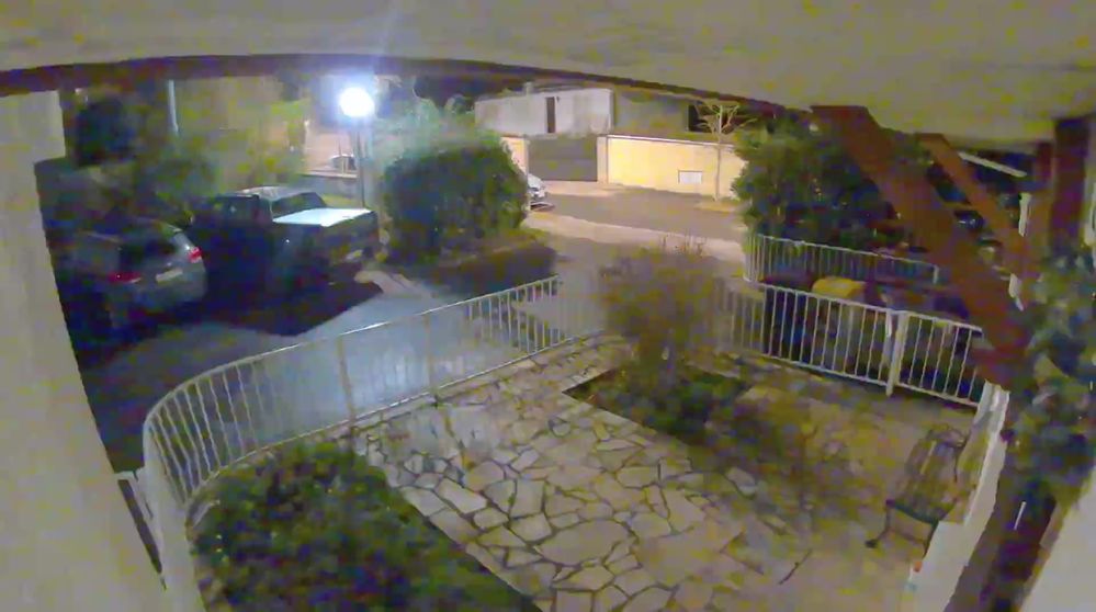

Thanks James, I am able to get MS Edge browser to play the videos within the Web UI, but the quality of the video I am getting is really grainy, see attached pic below.

I'd describe it as blurry/blocky myself. Does it look better during daylight hours?
I suggest tilting the camera downward until the street light is out of the field of view.
During the day the pic looks great. Before bed lastnight I did tilt the cam down away from the light. I'll take some photos tonight and check. Thanks for replying

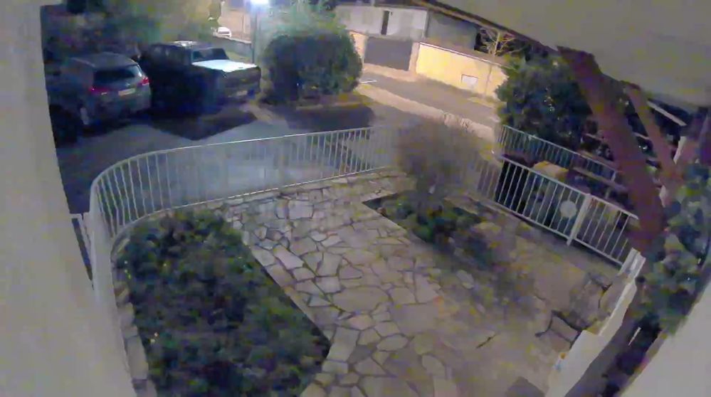

@Pucksterpete wrote:
Here's a more recent photo
Still not great. I think part of the puzzle is the lighting. The camera still could be lowered a bit more.
Nightvision might work better, so maybe turn off the spotlight in low light settings. You could also try toggling color and auto-hdr, and see if that helps.
Are you taking a snapshot, or is this a frame from the video?
I'll try the suggestions you mention.
The pics are from a snapshot.
I did notice last night that when my arlo spot light and another flood light turns on in the front area, the quality of the pic or video greatly improves.

The facts here are that the HEVC licensing terms for 2K and 4K are too expensive for browser vendors to integrate software decoding into the browser - so they've all chosen not to do that. FireFox and Chrome also don't support HEVC (at least with flash) even if the PC hardware acceleration supports it.
Since the HEVC encoding in Arlo is done in the camera hardware, I don't think Arlo can switch to a different compression algorithm. When Flash is removed, it is possible that Chrome and/or FireFox might be able to render the HEVC videos if the PC GPU has hardware support for HEVC @ 2K.

Chrome won't play 4K HEVC, so I am thinking your Ultra isn't recording 4K. Try downloading one of the videos, and double check. Note if you have auto zoom and track enabled, you are recording 1080p.
Edge will play 2K and 4K HEVC - though if you don't have hardware support for HEVC in your PC you'll need to install the Microsoft HEVC extension (which is free).

They use different video codecs. Edge works (though it might need the HEVC extensions package from Microsoft). But Chrome and Firefox won't play them (Google and Mozilla haven't implemented support for HEVC video).
