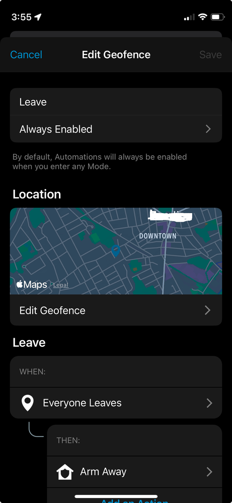

I tried doing as you requested. Is a mess. Still doesn't work. Here is a photo of what I'm asking just for leave (when no one is home). But it's not letting me choose if I want to record when it's either sound or motion. I can't figure it out.

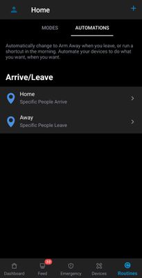

And then it still shows both as disable.
It looks like you're trying too hard. First, remove those actions for recording from the different cameras. Just use the Arm Away mode.
However, your screenshots show that Leave and Home geofencing automations are disabled. You'll need to enable those before anything works. I suspect that in your schedules (or possibly in your GF settings) you've gone into the Always Enabled section at the top and chosen to disable them. For the time being, leave the default settings alone until you're trying to solve an issue.

Here is an update of my current settings. But as you can see on my dashboard. It always shows as AWAY. never changes.

The "Arm Away" right under under the "Away" automation name is "Enable List". The automation only runs if the system is already in one of the modes in the "Enable List". So this one only runs when the system is already in Arm Away.
Change this list so that the automation is enabled in Arm Home, Standby.
Note the action (changing to "Arm Away" is correct, so leave that part as it is.
@Toledori wrote:
This one also has the wrong enable list. "Arrive" should only run when the system is in "Arm Away" mode. So change this list to "Arm Away"
Again, the action (switching to "Arm Home") is fine, so leave that as it is.
Thanks for the update. Here are some photos after the changes you subjected. Still not responding to geofencing correctly. As you can see under Away, it still shows disabled.
It's disabled because the system is already in Arm Away mode. Try putting the system into Arm Home, and it will be enabled.
