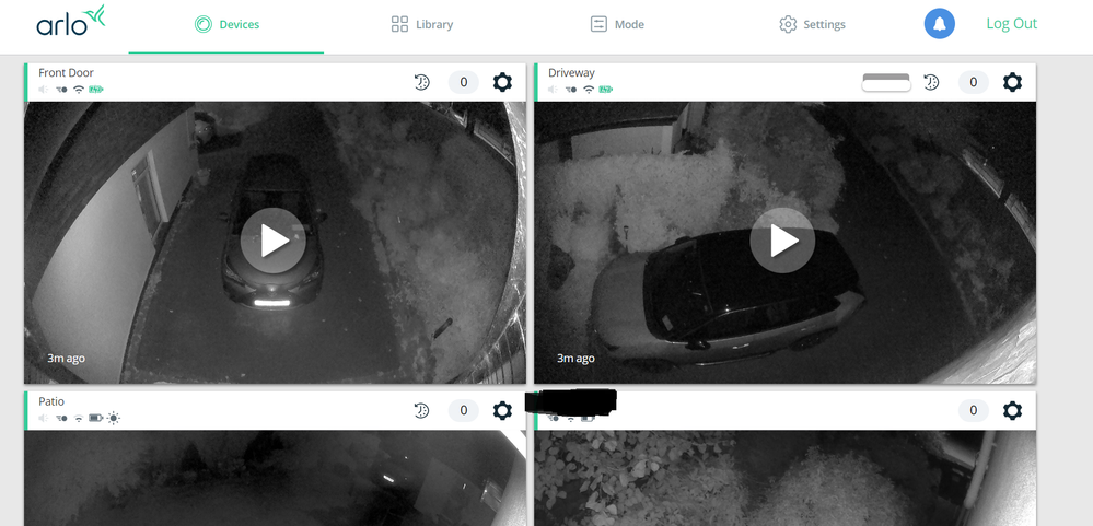

This happened again tonight for the fifth time. This time the settings on only one camera were changed in such a way as to make the camera useless for security purposes. I haven't gone through all the settings yet to see what's been changed because it's late and it's a hassle. This is a screenshot from the Arlo web portal showing the effect of the change:
Looking forward to seeing some kind of serious investigation on what's happening. It's almost as if someone's sending a message. To me, presumably, from someone Arlo, annoyed about my video or something petty like that. If that's true, that's the kind of thing that happens at Arlo with zero consequences for whoever is doing it. What else could possibly be the cause of this, right? Fix it please, fix it all, make it into a real security system.
For the record, this is what that camera should look like, just like the video.
Very few settings were changed this time (Thanks for that!)
Settings changed this time, all on 'Front Door' camera:
Zoom setting - changed such that only a tiny corner of the image is recorded
Power management setting - Changed from 'Best Video' to 'Optimized'
Local 2K live streaming setting - Disabled
Camera LED setting - Set to 'On'
Brightness settings possibly changed
Activity zones remained intact, camera remained connected to the SmartHub (as on all previous occasions), no other cameras affected this time. As usual, each time this happens it's slightly different, because it's being done manually, not a reset, these are inconsistent manual changes, done by someone with access. 'Security is in our DNA'.
