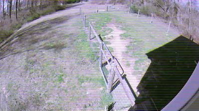

Old TV type lines on video
I've never seen this issue before, see attached pic. I've turned off the cam and back on remotely. Not near it to reset by pulling out battery.
The lines are on live view and recording and CVR.
Should I reset the base station or is this a camera failure?

I don't think resetting the base will help, though I guess you could try restarting it.
This looks like an issue with the sensor/image signal processor. I think removing/replacing the battery would be the best next step, followed by a factory reset of the camera. If not, and the camera is under warranty, you could contact support and get an RMA.
FWIW, this isn't a failure mode I've seen posted here before.
