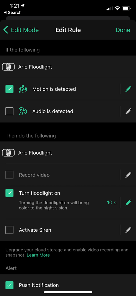

To elaborate on option 3, when I didn’t have my 3 month trial enabled the “Motion is detected” option greyed out “Then do the following > Record Video”. I’m assuming once SmartHub (with USB) is linked to my Arlo Pro 3 Floodlight, that should show differently?
Screenshot for reference attached.

@Koulie wrote:
To elaborate on option 3, when I didn’t have my 3 month trial enabled the “Motion is detected” option greyed out “Then do the following > Record Video”. I’m assuming once SmartHub (with USB) is linked to my Arlo Pro 3 Floodlight, that should show differently?\
I can't speak definitively on this but I would think so.
Under “Modes” the Arlo Floodlight now falls under the “SmartHub” and when you click to modify the “Armed” settinga everything is the same expect “Record video” is no longer greyed out.
I’m happy with this interaction and have found my long-term solution. I appreciate your assistance!
