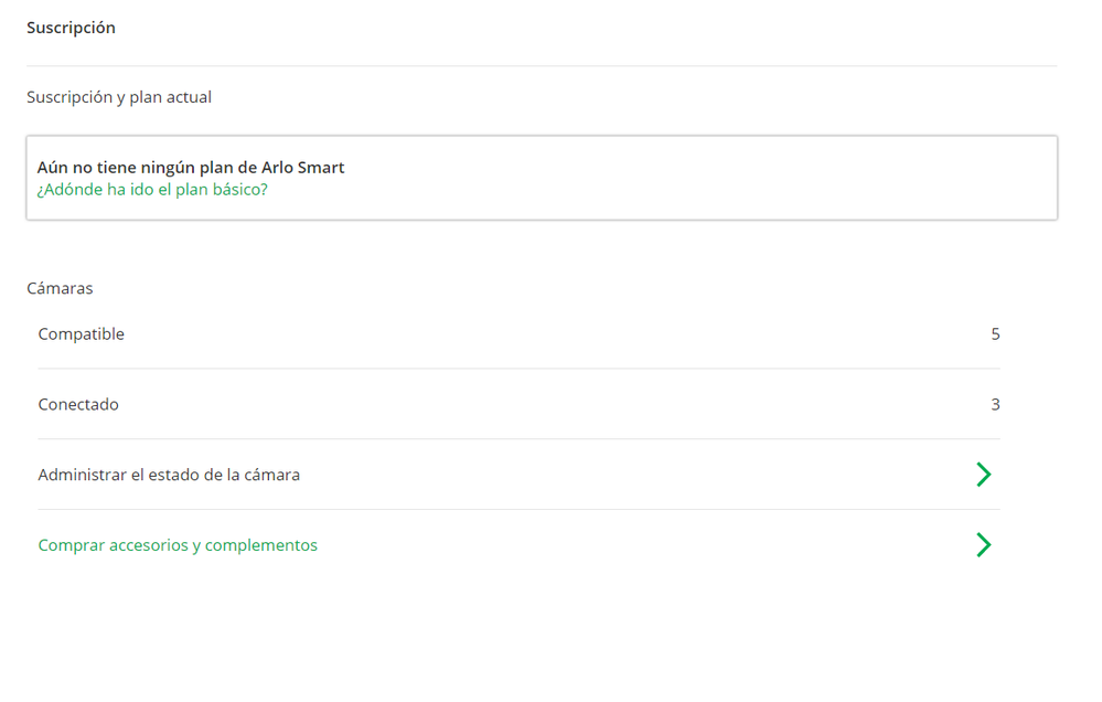

I attached image from my config, the new thing i have for the last 3 week is the "No Subscription plan yet" message.
Do you know if the problem could be because i'm outside US?
