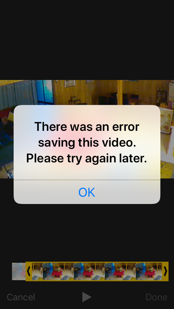

Does anyone else have problems saving edited (iOS' Photos app) downloaded Arlo Pro 2's video recordings in their iPhones? I keep getting stuck saves, corrupting saved files, and can't view/play after editing and saving (old and new files) the downloaded Arlo Pro 2's recording videos. No problems with the original Arlo camera's videos though. This is in my almost month old iPhone 12 mini's iOS v14.7.1.

Not sure how you reached that conclusion, but I don't think so. I was able to duplicate it by importing an mp4 from my NAS to photos (not a clip from Arlo). All I did was access the NAS with Files, and save that mp4 on iOS. It appeared in photos, and also couldn't be edited in Photos. I tried a mov file also, with the same results.
So I think this is actually something going on in Photos.
FWIW, the problem occurs 100% of the time with iOS 14.7.1 (at least, I never succeeded in saving to photos and then editing in photos).

I didn't have any Arlo videos saved in photos (I don't normally edit them). In any event, the googling I've done suggests that the behavior does depend on what version of iOS you are running, and we are running different versions (and different iphone models). It likely also depends on what iOS you were running when you archived the older videos.
Photos is definitely trying to get a higher-quality version of the mp4 (or mov in some of my testing) - which simply doesn't exist. I don't think it has any idea that the video came from Arlo. FWIW, if iCloud Photos is on, you will see the videos saved to Photos in a iCloud Photos album called Arlo.
I originally thought disabling iCloud Photos would work around the problem, but that didn't change the behavior. Various other attempts at making copies didn't work either, until I found the Files Editing Trick. I thought email might also work (since it creates a fresh local copy), but didn't try it - I was wanting to find a purely local workaround.

This shouldn't be a problem with iOS 15. I did find a (clumsy) work-around with iOS 14 a while back -
- Create a videos folder in Files (on the iPhone)
- Use Share in the Arlo app, then "Save to Files" Save it to the Videos folder
- Select the video in Files, and trim it in Files. Save to a new clip.
- Share the trimmed video
Now the trimmed video will appear in Photos, and can be further edited (straightened, etc) if desired.
Unfortunately for me I can’t complete the suggested workaround as my files app does not have the editing capability using iOS 12.5.5 on iPhone 5s.
It previously worked fine and worked ok on previous Arlo’s library recordings.
