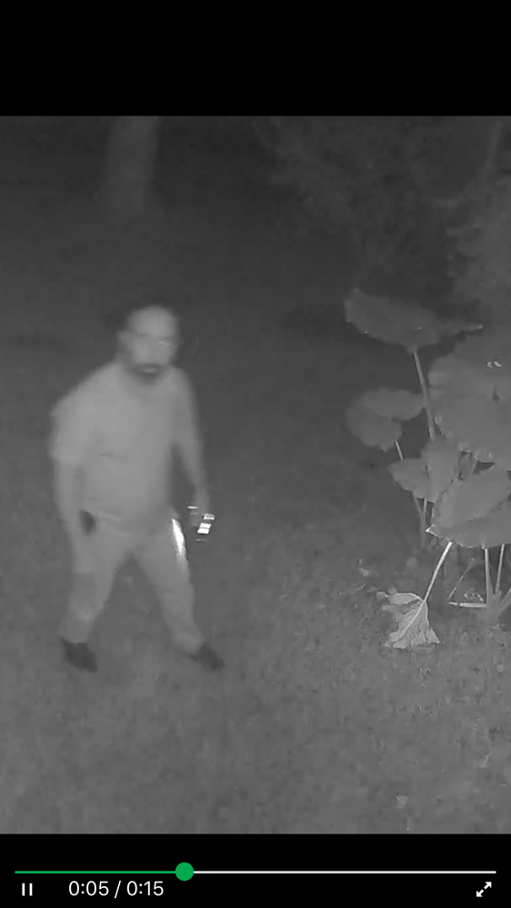

archon810
Apprentice
Apprentice
Had the same thing happen to me. Here's the image I captured:
I'm working with Arlo PR directly, so they're already aware of my issue, and now I'll bring this thread to their attention.

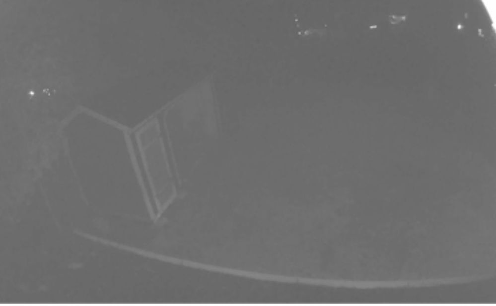

MrTonyToca
Apprentice
Apprentice
This is a night shot of the back yard, very grainy and washed out, cant really tell any details of the things back there. The arlo pro 1 was the complete opposite of this clarity.
Community Manager
Community Manager
MrTonyToca,
I am working with the engineering team to collect information on this issue. They have requested we try a couple different things to see if you experience any different behavior:
-Try another pro 2 camera in the same location.
-Try the pro 2 camera in a different location without any adjacent walls/ceiling near the camera.
-If you have a skin on the camera, try with and without the skin.
Please let us know the results and if possible provide screenshots.

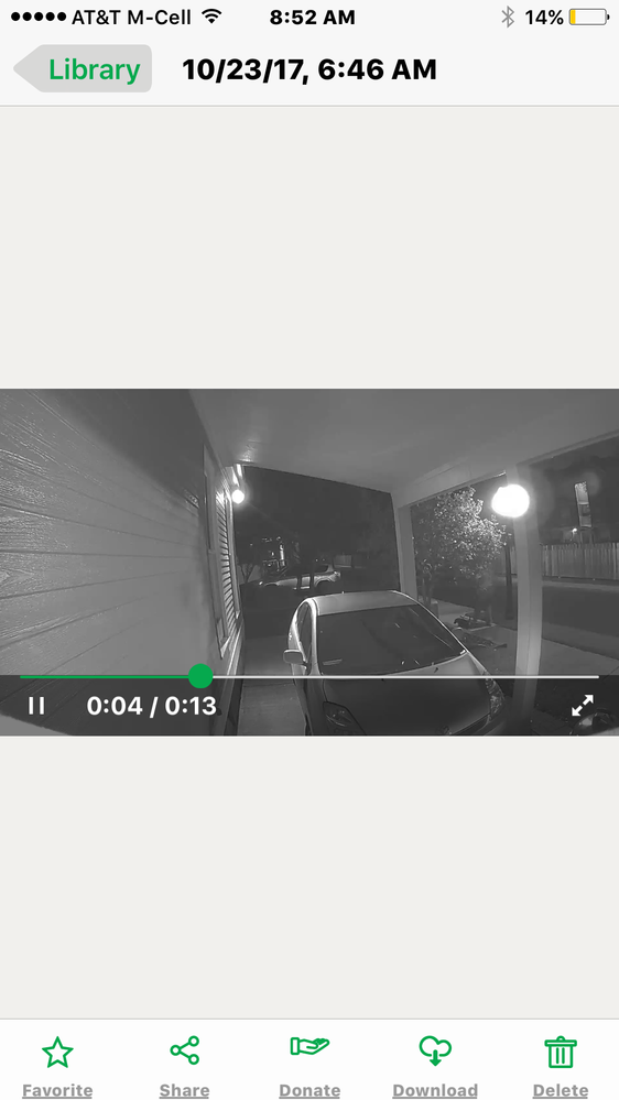

Take a look at my view last night through the camera.... This is what Netgear considers "NIGHT VISION", it was raining last night but that isnt an excuse as my driveway arlo pro 2 did not look this bad last night, and through hail sleet and snow my Arlo Pro 1 never looked like this.... its sad...
My night vision view last nightMy night vision view last night
Community Manager
Community Manager
For the best experience with the Night Vision feature make sure that no walls, tables, or other objects are too close to your camera. If any objects is within 2.5 inches (6.4 cm) of the sides or front of your camera, it can reflect IR back into the camera lens and cause glare or hazy video, especially at night. Be sure to reference the following article for best positioning tips: How do I position my Arlo Pro 2 camera?
The engineering team is still actively investigating other night vision issues being reported. We will provide updates on these as soon as more information is available.
