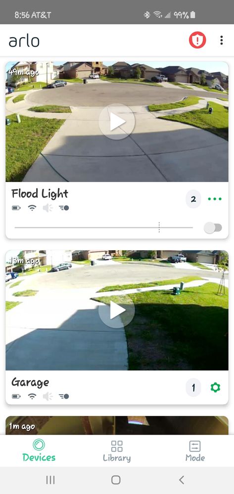

I purchased the arlo pro 3 flood light today. It has the exact same zone for motion as one of my pro 2 cams. The flood cam caught the activity all 3 times it happened today. The pro 2 cam never even went off. If I can't figure out a solution I'm going to junk the pro 2 cams. They seem to be pretty useless at this point. Im just glad the flood light cam is taking up the slack.
