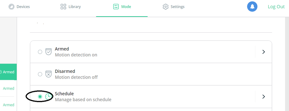

Did you remember to set the mode to "Schedule" after you created the schedule?

Your earlier schedule screen shot is blank between 7 am to 8 pm. That means the cameras will be disarmed during those times. If you want to schedule your custom mode during those hours then you will need to edit the schedule and fix that.
Also, to use the schedule, you will need to choose "schedule" as the mode.

You got the mode correct already - which is the hardest bit. You just didn't schedule it in your earlier screenshot. The schedule needs to look like this:
So not blank during the day.
And you also need to activate the schedule.
