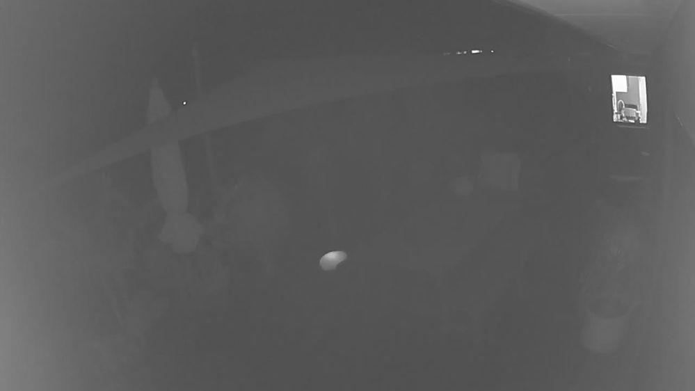

Well just purchased a 3 camera pack and its not what it promises. The night vision outsite is poor beyond believe. I tried all the troubleshooting suggestions, nothing. Through my research I have come to the conclusion that you require additional light sourches to get anything.

That image is not normal.  It looks like there is a skin on the camera or maybe the plastic protective film that ships on the lens was not removed.
For best results, you also need to aim the camera away from any walls or objects close to the lens, to avoid IR light reflecting directly back into the lens.  This is the case with any brand of IR camera.

Nope no film on any lens. To mount a camera on a wall and to protect it from the elements there is no way to point it any other way. I want to monitor my backyard and not my neighbours

Do you have a skin on the camera?  Can you post a photograph of the camera showing how it's mounted?

It appears to me the camera is setting its exposure level to the optimal setting for the window in the upper right of the image,  Since that is correctly exposed and the camera doesn’t have HDR, the rest of the image will be underexposed.
Some locations are better served by cameras with a narrower field of view.  I have found 130° or 140° can catch too much of the sides of house or nearby objects.  This results in IR scatter or difficult exposure situations where the exposure is optimized for objects that are not of primary interest.
If that is your window, try turning off the lights in that part of the house.  It that is your neighbor’s window, try positioning the camera such that the window is not in the image.

The bright window is definitely a problem.  Capturing an image with the light off is a great idea.
It doesn't look like the only problem though.  The image looks hazy, like something is reflecting strong IR light back into the lens. This can happen with a skin on the camera or if the camera is too close to a wall, or there is foliage or reflective objects close in front of the lens.

I have the same problem. After disabling night vision the "fog" disappeared. I have a yellow street lamp out front that in combination with wet weather may be defeating the camera.
Some folks have had an issue with using a skin on the camera with night vision. Turns out the issue has been the IR illuminators were reflecting off the hood of the skin. Removal of the skin (or modifying the hood) has resolved these issues for some. Also, the exact positioning of the camera can be an issue since the IR LEDs can be reflected off nearby walls or other objects, causing flare in the video. Careful repositioning can fix this.

Thanks for your post. These cameras are rock solid in dry weather. No issues.
But the rain has caused IR (i suspect) and other issues like real fogging related to
water vapor. I have a camera under some eaves and it never has an issue, rain or shine.
My next step is to reposition the foggers, and maybe shelter them as well.
No skins, btw.
