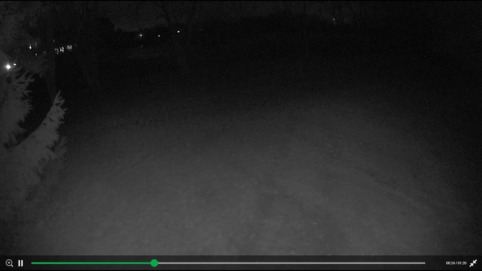

Had the same thing happen to me. Here's the image I captured:
I'm working with Arlo PR directly, so they're already aware of my issue, and now I'll bring this thread to their attention.

Here'e two of my camera's nightvision shots. Unacceptable. I need to return all six cameras in three days if there isn't a fix. I'm just really suprised that Netgear pushed out this product without vetting it.
For the best experience with the Night Vision feature make sure that no walls, tables, or other objects are too close to your camera. If any objects is within 2.5 inches (6.4 cm) of the sides or front of your camera, it can reflect IR back into the camera lens and cause glare or hazy video, especially at night. Be sure to reference the following article for best positioning tips: How do I position my Arlo Pro 2 camera?

I'm on the latest current firmware and don't use any skins or hoods, and this happened again to one of the Pro2s after the last rain:
I'm hoping they can sort this out in software, but it could be a hardware issue.
Could be but post the same scene in daylight so we can see what the scene should look like.
Here's what it usually looks like at night and during the day.
We need to let the mods approve the images before we can see them. Might be tomorrow.
archon810 wrote:Here's what it usually looks like at night and during the day.
Is this with AP2? Because that looks pretty good!
.......... I was going to say! That is a great night time image, probably due to good "ambient" light! Take away the ambient light, and it will probably be somewhat grainy and pixelated!! From what I have been reading from other customers, seems there is a compression issue??
