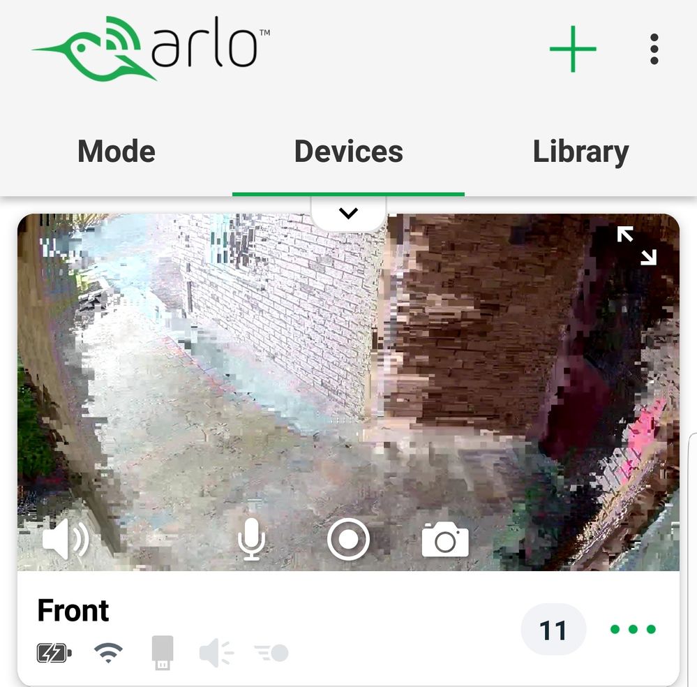

All the sudden the live view of one of the cameras is displaying extremely pixelated, and it appears that the video is repeating on loop. Cameras are on the latest firmware.
Screenshot attached
Looks like heavy interference. Can you change your wifi router to a different channel for the 2.4GHz network? After that, if not better, power cycle your base station
Can you please clarify your a recommended solution? When it comes to networking I am not to tech savvy.
For someone not savvy, I'd say start by powercycling your wifi router. If you are a bit more savvy, you can login on your router and manually set the channel which the 2.4GHz wifi network runs on
As per your suggestion, I logged into my router settings and changed the channel to one that does not overlap. The solution seems to have lasted two weeks this time but the issue has resurfaced. I'm not sure if I should change the router wifi channel again or if there are any other suggestions.
Thanks
Can you use a Wifi Analyzer app on your phone to find out which channel is least congested?
