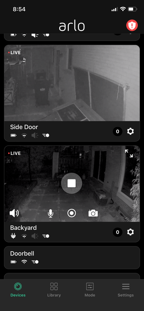

Of my 5 cameras, one has always had a rather “cloudy” or “foggy” night image. Has anyone else seen this on there cameras and does anyone have a solution to it?
You can see it in the attached screen capture. The top image is the camera in question. The lower camera is how the other three also look
I did two things. 1) I angled it away from the wall slightly, not to much. And 2) I moved the sides and top of the shelter I had built around it further away just a bit. One or both of these things solved the problem.

I think it's due to 2 things:
1) The nearby wall is reflecting the IR for night vision, causing
2) the camera's autoexposure to try to adjust.

My suggestion was that the wall could be the issue but anything that reflects the night vision IR light, including your cover, could do this. I would rotate the camera to the left to minimize the view of the wall to see what happens.
