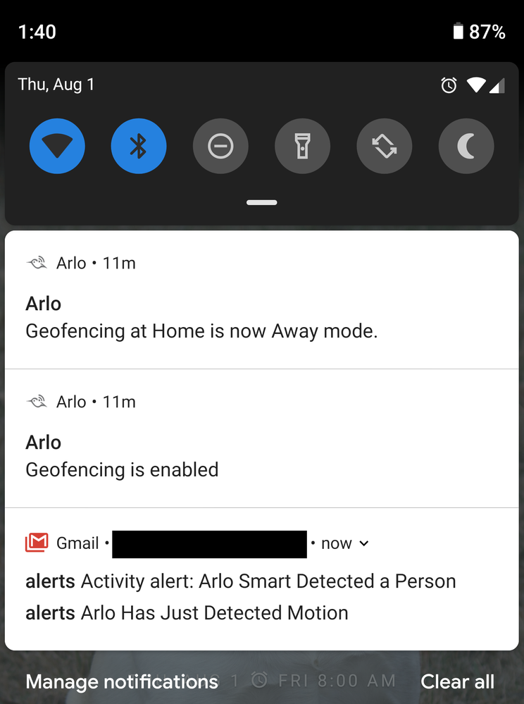

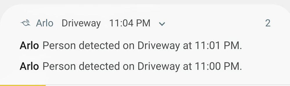

Here is a good example. Recent notifications showing up in email, but nothing from the app itself. Note that I have tried manually arming the system, but I default to Geofencing.
-Edit-
As I was typing this I got 2 more notifications on the same camera about 2 minutes apart. Recieved two emails (one "Smart" notification, one not). Recieved one push notification from the app, not a second.
