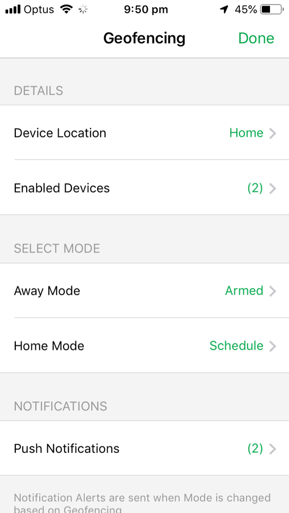

When you go into arlo mode menu, select edit pencil on geofencing and select the enabled devices option and then deselect any phones enabled, close the App. Open the app again on phone and enable both devices at the same time. Close the App again then open the App on the other phone and repeat the above steps.

I'm actually trying to get the darn geo-fencing to work for two people but their cameras are unable to do it. The programming is faulty and it only works for the primary account holder. So I set my wife up as the primary on her phone and added myself as a guest. I wanted to be able to control the base station from my phone because she is clueless about technology. I have been in contact with Arlo support trying to get a fix but they are hopeless. They just keep referring me to a higher level and then never getting back to me. I've given up with those clowns.
I have geofencing working on two iPhones but using one account on both. I.e no sharing.
Both devices are added in geofencing settings although had issues whereas I had to add them both at the same time.

How did you add both phones at the same time if you can't have both phones logged in simultaneously?
I installed the arlo iOS App on each iPhone and used the same login account.
I then during the arlo installation I set the phone to allow the location data as always.
Then when you setup the geofencing settings, it shows devices to use and shows both iPhones.
The iPhone settings for for the arlo app should also give you access to the above location as well as run arlo in background. See attached.

Thanks man. Its night time here in Australia so I'll have to wait until tomorrow to give it a try. I'll report back when tested. Cheers. Sean.
I’m sure that arlo will get geofencing working the way it should sometime in the future.
Be warned that you may need to recheck the operation after an App update or firmware change as these can break the workaround.
