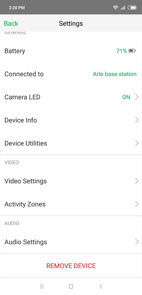

2) There is no option to do a motion test. I just do not see where I can do it (I followed the tutorial on youtube but do not have the "test" in my mobile app and not in my computer - n see it is missing in the attached screenshot).

2) the motion test is in SETTINGS / camera/device utilities / motion test
***BUT this is for testing purposes...the real setting for motion detect is in the Mode ARMED
3) The setting in the mode usu runs about 90% tho the default is 80... then you set the record time ( use a fixed time over till motion stops ). The camera detects motion then records for the set timeand stops... resets after for about 10 secs, then cycles again.
