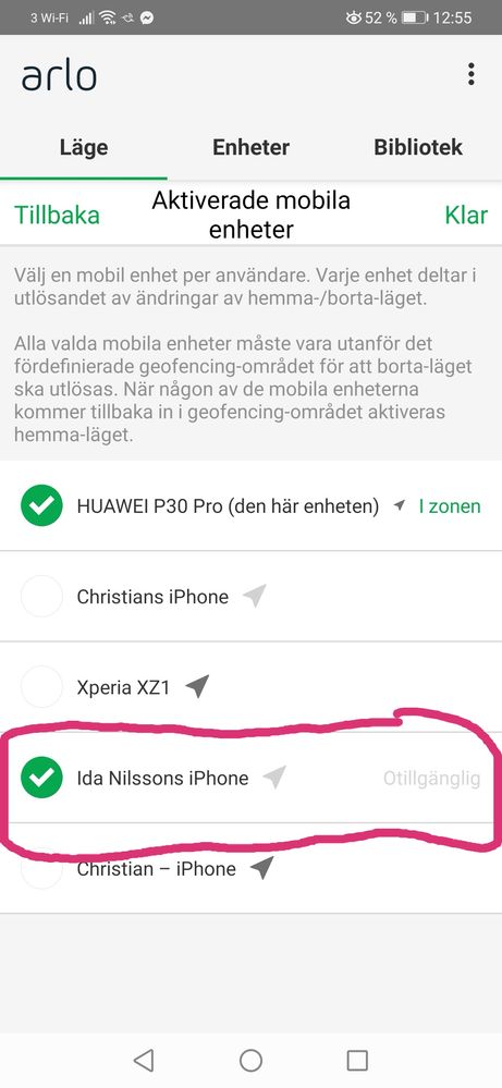

Hi. I had the same problem. I managed to solve it. In the modus screen select pencil behind geofencing. Choose activated mobile apparatus. You’ll see both phones. You have to check the box for each phone. In my case the box of my wife’s phone was not checked. After checking the box her phone is recognized. I hope this helps

My phone (iPhone XS) has finally started working properly, but every 1 or 2 days my wife’s phone (iPhone XR) is no longer visible to Arlo and shows “unavailable” in the enrolment details.

my 2nd Iphone still showed as "unavailable"
