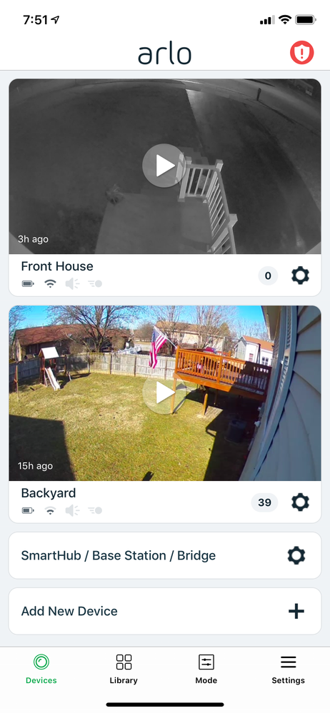

Like the title says, random times when my system is armed when I am away from home I get anywhere from 20-111 motion recordings almost right after the other. No rhyme or reason and doesn’t do it all the time. Most of the time the system is fine but will randomly do this and drain my battery. I have rebooted the system multiple times and have removed devices and removed batteries and reconnect to the system.

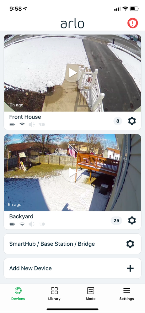

It may or may not be related to detection (sun's IR being reflected is a big culprit) but you haven't given us enough clues nor a detailed explanation of what you've tried.
For starters, is all firmware up to date? Post screenshots of the camera views. You may want to reset the system byt removing everything in Settings, My Devices and start fresh.

Happened again, usually only during the day, if it is the sun what am I suppose to do about that? It doesn’t do it all the time only once a week if that
Backyard, I assume. Could be the flag waving in the wind which, of course, is variable. I would rotate the camera down so the top of the view is maybe the top of the fence - you really don't need the sky. If that's not appropriate, you may to reposition the camera to a different location - cover only the area of interest, not the whole neighborhood.
