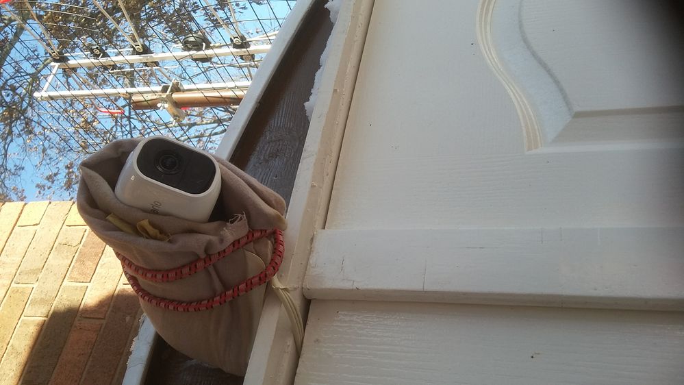

Yesterday in Brantford Ont. the temperature dropped to -18 C /-3 F My Arlo Pro 2 outdoor cam was giving me messages that the battery pack was too cold to permit charging from the a/c adapter the battery was down to 84%. I took an old heating pad and wrapped it around the camera and tied same in place with a bungee cord (see attached) a very rudimentary fix. I keep the heating pad set on low but it provided enough heat to warm the battery pack to hold a full charge. Obviously I'll have to take this camera heat source a step further in order to make something weatherproof. However for the time being the cvr feature appears to be working with the exception of a couple of hiccups this am when the cam went into dormant state.
nice out of box thinking... glad to hear it's working for you... stay warm

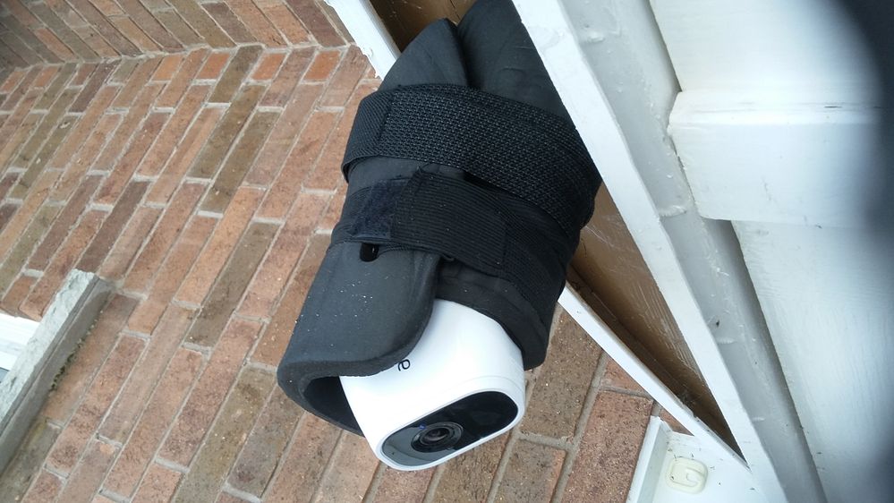

Further to my last   It is   -22   Celcius  this  am   here in  Brantford   Ont.   My Arlo  Pro   2  is a  little reluctant   to give me CVR    however the motion trigger is working well . I  have fashioned  a   cover made   from Dollarama  knee pads   wrapped tightly around the   rear  portion of the  camera.  Held in place by velcro straps. At this time there is no external heat source. The battery indicates a full  charge. See attached.
