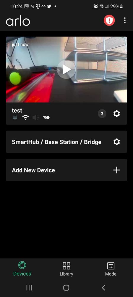

So I left the camera plugged in all night to my computer. I now know the battery is fully charged as I can see the battery icon full after I unplug it. Now I get this message "Your Arlo device appears offline. Make sure its powered on and connected to the internet". It was connected to internet when plugged in. My base station is connected to the internet. I've attached some pictures.

Are you seeing the same indicators when you power the camera with the charger, but with the battery removed?
This is what I see with no battery but camera plugged in.

So the battery icon is just replaced with the power plug when plugged in - whether the battery is inserted or not??
And the only time you see the battery icon is when the camera is off-line?
Correct. When the camera is plugged in (both with and without battery) it shows the plug icon. When the battery is in and I unplug I see the battery icon showing full (it's grayed out) and then get the offline message on the video screen. This is happening on all 4 cameras as well.

What you are supposed to see when plugged in with the battery inserted: A battery icon with a lightning bolt.
I am still thinking this is the charger or maybe the cable (no longer supplying 9 volts).
