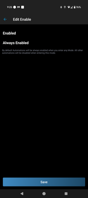

In the top box that now says Arm Away but was originally named Always Enabled, enable all modes. However, I just tried editing my leaving home automation and that doesn't work. There's an Enable as well as an Always Enabled selection but choosing either one has no effect - it always remains as Always Enabled. This is on a Pixel 9, Android 15 with the latest Android app, 5.5.2.

Here's what I see in the Android app when selecting the Always Enabled section from the main automation screen. The 2 "selections" don't do anything.
Clearly broken.
Can you still enable/disable the automations using the mode screens?
Yes - there are toggles for each automation while editing modes.
GTK. Maybe they are thinking it would be less confusing if the automation lists were just in one place???

@jguerdat wrote:Here's what I see in the Android app when selecting the Always Enabled section from the main automation screen. The 2 "selections" don't do anything.
is this 5.5.3?
As pointed out by @StephenB , ARLO may have decided to keep this enabling/disabling at only one place --- the toggle switches under mode screen. This may be a good move, given:
- the flexibility of allowing user to edit this from mode screen OR under each automation has proved to be adding just confusion, instead of any value (even though personally I prefer the "older" design)
- the wordings/explanatory text have been confusing users
If above screen is the newly (and clearer) way, then again the wordings are still confusing. This screen should not longer be called ❌EDIT❌ Enable!
Alex
Actually if they are shifting to only enable/disable the automations via the mode screen, then they don't need this screen at all.
@StephenB wrote:
If above screen is the newly (and clearer) way, then again the wordings are still confusing. This screen should not longer be called ❌EDIT❌ Enable!Actually if they are shifting to only enable/disable the automations via the mode screen, then they don't need this screen at all.
agree. Just lazy if not senseless UI design change.
