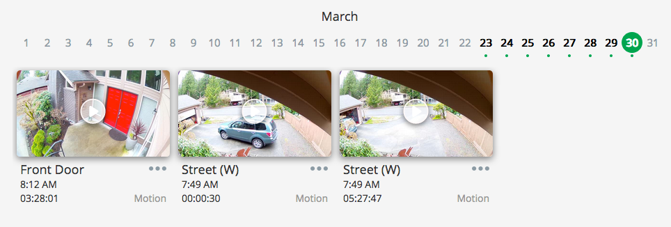

The events captured are reporting vastly incorrect duration times... For instance, basically every other event..ie: one event duration reads 03:11:11, the next (seconds later) 00:17... Then shortly later (seconds) 03:10:40... all on 3-29-18. This is what's being recorded every day..!! The current firmware versions are...Base .. 1.9.8.0_16666 and Cams .. 1.125.5.0_17202. Also, those events with the very long reported times, only show a very short duration of motion, then freeze from that point on..?? Something's not right!

Not sure what you exactly mean. I suspect you're seeing videos that are hours long even though your modes call for seconds. If you view the videos, they will typically only play for the proper time, even though they show longer times. Also, they don't consume storage on the cell phone when viewing since you're just seeing what's on the servers. If you download them, they're not actually taking the amount of space that it appears they should take since it's a display issue embedded in the video, not an actual length.

You are correct, we are getting videos that are hours in length when the motion is only 10-20 seconds at the begining of the video. When we play it back it does play for the stated duration of the video not just the time motion is detected. I have changed the recording time to a set duration, then back to default of 300 seconds and it still occurs.
