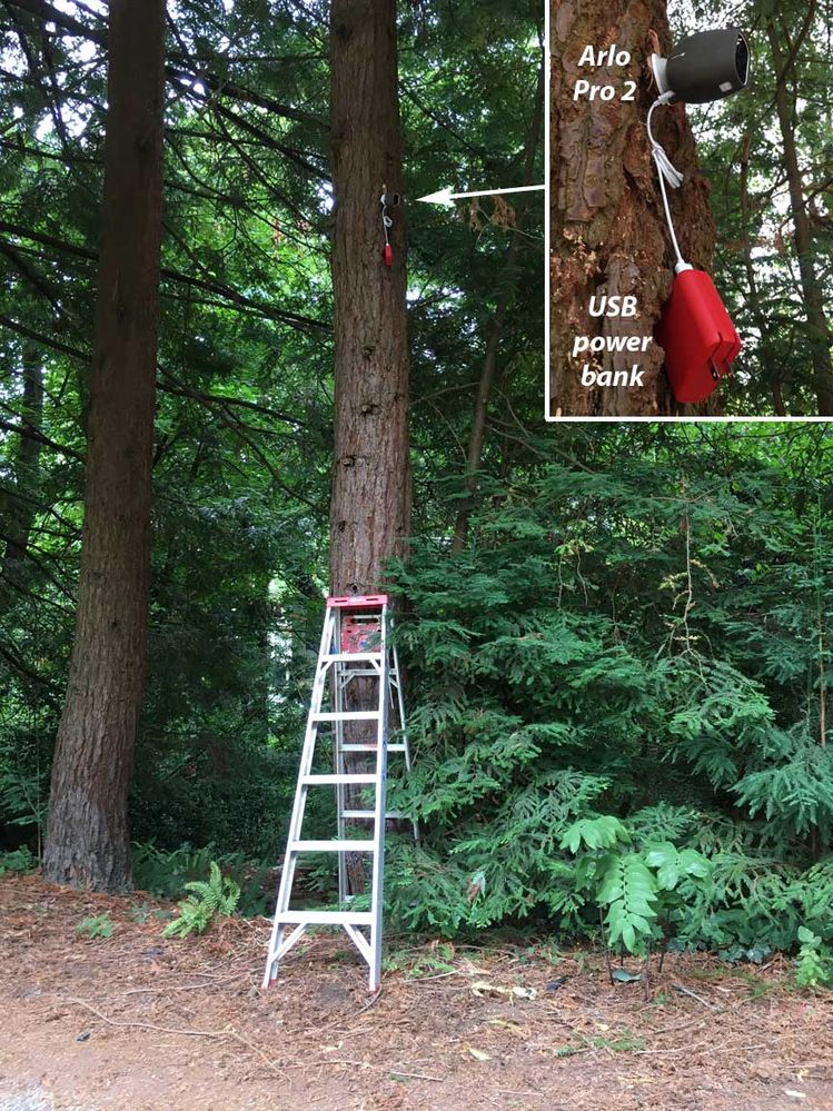

I tried a USB 2.0 powerbank and it did not work. (It's the red one in the pic up in the tree.)

I tried to include all the info in the one pic.
Anyway this should make your Arlo Pro 2 much easier to operate in a remote location.
