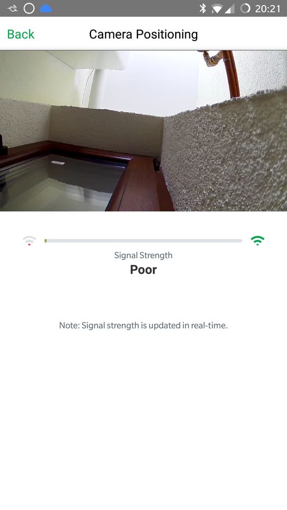

Which signal strength indicator are you using? The one in Camera Positioning seems to be faulty, always displaying Poor. Use the WiFi indicators for each camera on the Devices tab.
@timi wrote:
Hi folks I bought a new Arlo Pro 2 kit (base+1 pro2 cam) although the camera is near the base station the signal is always poor, is there any thing I can do, is my kit damaged or something?
Thanks for helping
Dan
The photo appears to show masonry walls. Those are great for stopping signals.

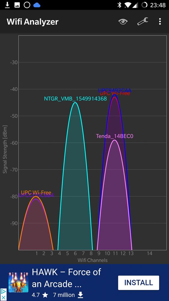

tried dancing in front of it, same result, poor signal 😐 there is no other device transmitting on the same channel, the camera is in the line of sight like 4 meters away from base, in the same room.
@jguerdat wrote:Which signal strength indicator are you using? The one in Camera Positioning seems to be faulty, always displaying Poor. Use the WiFi indicators for each camera on the Devices tab.
thank you, this is the answer I was looking for, indeed I was looking in the Camera Positioning, the signal in the Devices tab shows maximum, maybe Arlo will fix this in the future, it's really confusing.
