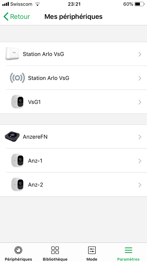

I'm using 2 Arlo Pro 2 with the Netgear Mobile Router MR1000 (also called Netgear Nighthawk M1) which has an internal Arlo Base Station. The recent installation and sync worked fine and I can watch the monitored scenes. My big problem ist concerning the batteries which are draining within <24h. I rebooted the router and recharged the Arlo 2-3 times during a whole night and can not notice any increase in the autonomy of the batteries. The cameras are less than 10 meteres distance from the router and the signal is strong. I also checked the latest firmwares on router and Alro ... I set the battery optimization to "optimized" ... nothing helped so far ...
In comparison I also have another installation in a second home with the Arlo Base-Station (VMB4000) and one Arlo Pro 2 and this works fine, sufficient autonomy ... nothing to complain about.

In the meantime, I "de-registered" the Arlo-Base from the MR1100 and removed the batteries from both cameras for about 10 minutes. I re-inserted them afterwards and restarted with the registration process from the beginning. I've just done it an hour ago and therefore can not tell if the battery-life will be better ... i'll keep you posted tomorrow.
Just to make sure : my MR1100 is running without the battery since it is hooked on permanence on the wired electricity. I also join the firmware versions to compare with AncientGeek's experience. All devices tell me to be on the latest firmware ... I noticed that the Arlo P2 on the VMB4000 (my other Arlo Base) has a more recent FW that the one hooked on the MR1100 ...

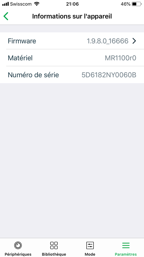

Since I couldn't find out how to insert multiple screenshots I write down the FW versions:
MR1100r0 on Netgear= 1.9.8.0_16666
Netgear itself = NTG9X50C_12.04.02.00 (could not find any indication of a date of release)
Arlo Pro 2 H3 = 1.124.0.0_14570 (2x)
my other installation (without battery issue):
VMB4000r3 = 1.12.0.0_27099
Arlo Pro 2 H3 = 1.125.11.3_26229 (1x)

My Pro 2 cameras are at 1.125.8.0.19174 and 1.124.0.0.14570.  Rebooting the base and pulling out the battery did not help initiate a firmware upgrade.  I may try tethering the MR1100 to see if that makes a difference.  Cameras are still at 100 battery.
The camera firmware versions are tied to the base version, AFAIK. Since the M1 uses a different version of firmware from the base (unless they've managed to coordinate them), the camera version would be different from those connected to the base.

I confirm ! Even after de-registering and re-initiating the sync of cameras, one through the iOS-app and once through web-based from computer, the result is the same ... my cameras are drained within less than 24h !!! That is usless for me and very disappointing ... I guess I tried everything your hints suggested so far. What shall I do next guys ?
