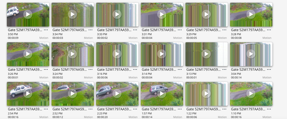

Arlo Pro 2 Striping interference. Getting worse. See screenshot.
VMS4230P - Striping interference on video - intermittent problem for a few days and getting worse. Camera has been in place 2 years and nothing has changed in the setup or environment. Battery has full charge from solar panel. Other camera is fine. Wifi connection is one bar but it's been working well for 2 years until now. Screenshot attached.
1 REPLY 1
This is video stream corruption - generally caused by loss on the connection.
If you have another camera, try swapping them, and see what happens (for instance if the problem moves with the camera or stays with the location).
