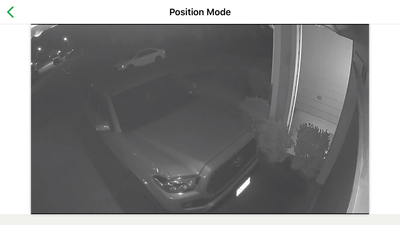

After syncing the camera and disarming the hub the quality of the night vision was as below –
** Please be aware that the IR is not reflecting off the license plate but it was coming in clear, you could see all the digits in the license plate. I went ahead and cover it with a white line across for Privacy concerns.
Fresh install. - No change in lighting.
Scenario - After confirming the quality, I decided to turn on a light that is to the left and below the camera. Almost Instantly the camera increased in brightness as in trying to compensate for the extra light.
The issue – After turning the light off again the camera never reverted to its normal brightness and stayed “washed out” permanently.
"Washed Out" effect. Software compensating?
Further Testing is needed and I will see if I can reset this camera back to factory settings or just sync my 2nd one that is still in the box and replicate the issue.

The only "reset" of the camera is to pull the battery and replace it....
Tho as a full settings change you may want to use REMOVE DEVICE ( in settings ) and bing the cam back as if new by resync'ing
Thanks TomMac!
I went ahead and removed the device then removed the battery but it seems that the Hub still remembered all of its settings. The night vision quality seems to have improved as I went and took another picture to compare but it could just be my eyes playing tricks on me.
Do you know if the security concern when returning the product and someone else utilizing the cameras has been resolved? Or are they permanently tied to the original account?
Thanks again!
