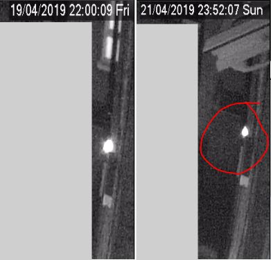

Hi, I am hoping very much you guys can help me as Arlo Support was confused.... I have had Arlo Pro for a couple of years now no issues and early this year I upgraded my camera at my gate from a Pro to a Pro 2 and I got an Arlo VMA4900 outdoor power supply for it to use the 3 second pre-record. I also have hard-wired CCTV but these are high up for a wider view of my garden but on one camera I can see the Arlo Pro 2 and in February it snowed here and was a little cold and I noticed on the hard-wired CCTV that the Pro 2 was dimming and getting bright again. I then noticed that the Infrared light had dimmed so much it was virtually off. As this was very bad I returned the camera to the place I bought it from and bought another from a different place. That was in February and then once again in March pretty much the same thing happened so I spoke to Arlo Support who were confused and told me to try moving the camera closer to the Base Station which made no difference and also to try removing the battery for 30 seconds and putting it back in but again no difference. Then they said I can send it to them as it's under warranty and they would send me a replacement but I had to pay shipping which I felt was unacceptable personally. As they said that and I hadn't long owned it again I contacted the seller and returned it to them and bought a new one from yet another store. Everything seemed fine up until 20th of April when yet again the Infrared light has dimmed so it seems either Pro 2 cameras aren't very good and this issue happens every month to everyone's or something else is happening? I know my set up will be rare as not everyone will have a hard-wired CCTV camera recording 24/7 and it see the Pro 2 camera to notice this happen but I'm very glad I do although it's very annoying this keeps happening. I have attached a couple of images showing what happened the other day and the difference between when it was fine to how it is now.

Couple of questions.
The attached photo shows the brightness changes within 48hrs correct?
Have you applied pinch and zoom and or activity zones to the camera?
This could be a long shot but is it possible that the CCTV infrared is causing the arlo camera to auto dim the IR Leds to reduce flare?

Hi,
Thank you for your reply. The pictures are from over 3 days as the before picture was from the 19th and the after is from the 21st. I am 100% positive the problem isn't related to the Infrared from my hard wired CCTV camera as it's much too high for the Arlo Pro 2 to be affected and the Infrared on the hardwired isn't high powered. I am also very sure it's not down to this because this seems to happen after almost a month of having it and nothing like it happens before and if it was down to the Infrared light it would happen a lot more and then fix it's self.

Does the LED behaviour change if you remove and reapply external power to the camera?
Are you using the arlo supplied cable and power adapter?
The fact that you have this the third time on different cameras and that the issue appears after 48hrs points to firmware issue.

Hi,
Thanks for the reply. I don't have any Zones set up so I just went in to the app and created one which made no difference and deleted it again and no difference. When I remove power the Infrared goes off and then when I trigger it by passing in front of it the Infrared comes on but at the same dim level. I am using the Arlo VMA4900 outdoor power supply plugged in to an outdoor weatherproof socket enclosure. The firmware is personally what I thought was the cause but I haven't actually had a firmware change in a while now and certainly not in the past week or so. As I thought it could be down to the firmware I would have thought others may have came across this and Arlo would be aware this happenesand have so sort of fix but the answers I got from Arlo Support weren't helpful at all.

Although you observe the dimming via the CCTV, have you noticed a visual reduction of night vision on the pro2 camera that is consistent with the CCTV camera?
One more test would be to remove the battery and just run on external power. It’s possible that the charger is changing the voltage to charge the battery. This is normal for quick charge by Qualcomm chargers.

Thanks for the reply. I tested this last night as I decided to try the removing the batter again and waiting 10 minutes and when I removed the battery it was still plugged in and I noticed the camera still functioned which was news to me as I thought you had to have a battery in it to work. Sadly without the battery in though the Infrared was still the same and there doesn't seem to be much I can do so far to fix it again. Currently there is no change in the view from the camera in question but the one I had go faulty in February got so dim the Infrared was almost off completely and that time you could see how much poorer the picture was.
