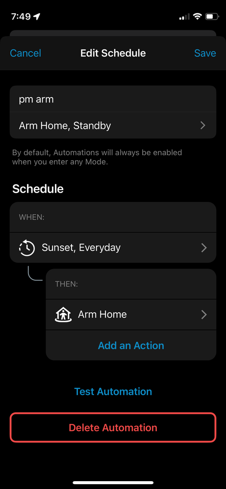

No kidding.. I spent over an hour with their support team trying to replicate what was a simple schedule in the old app.. turn on and turn off at sunset and sunrise.. he couldn't help me. I have to select the Mode manually!!
This will work.
