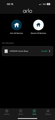

I don’t see anything setting in Modes other than arm or disarm all devices.
Try pressing the > at the end of the line that starts with your base station.

By the way found the mode setting. The rule for audio was off and just selected it. See what happens if I catch another. Thanks so much!
