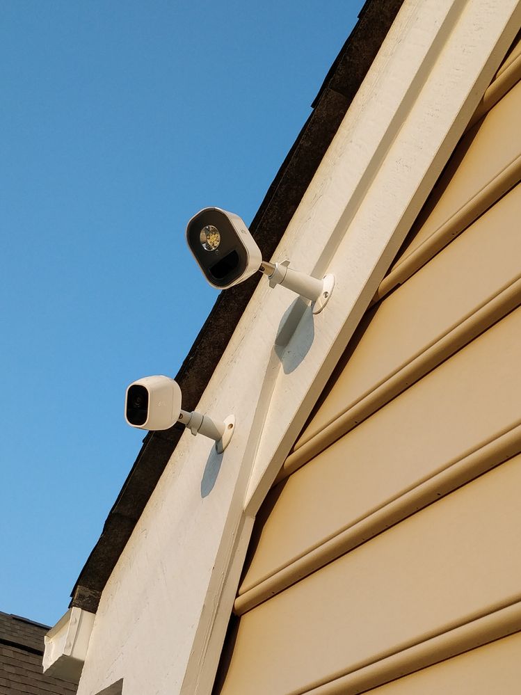

Hello, I've been battling this issue for the past week but I've hit a wall. My Arlo Pro 2 camera is no longer detecting motion at all anymore. I have it placed outside sitting over my garage sitting next to my Arlo Security Light and it no longer picks up motion. My Arlo Pro camera works like a champ and has never encountered this issue. I've tried rebooting my Arlo app, removing the battery, removing my Arlo Pro 2 camera from my devices in the app and resyncing the camera, turned my sensitivity up to 100%, and nothing is seeming to work right now. The camera still works when I go to the live feed but it's not picking up any type of movement at all. The camera hasn't been dropped and I only handle it with gloves. Do you have any suggestions or is my Arlo Pro 2 camera defective?

Update: When I performed just a battery swap by itself last night the motion detection came back on but when I came home from work in the evening the motion detection wasn't working again. I'll try another battery pull by itself and see if I have better luck.
Frenchyk
*New Development * Now the Arlo Pro 2 camera is triggering motion detection with no motion going on. I literally have the camera facing a wall and it's triggering alerts of the wall. All I did was remove and reinstall the battery. I'm befuddled.
