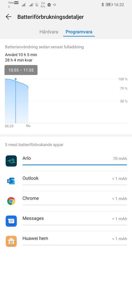

Still having battery drain, not sure if it's as bad as before, but for my Samsung S9+ the battery has drained 5% in 5 hours. So geofencing is usable but not sure i think the result is a complete success. ~15% battery drain during one day (15h) for an app running in "background" is to much.

Directly following the app update to version 2.7.10.25620, I am having excessive battery drain from the Arlo app geofencing background monitoring on my LG Nexus 5x. It has jumped from about 1% battery usage in a 24 hour period to 20-25% battery usage in a 24 hour period, placing it well at the top of the list. I have restarted the phone several times in addition to uninstalling/reinstalling the app. Is this a known bug with a fix in the works?
For me the geofencing works ALOT better with this update, the best ever actually! It detect in/out of zone as it should, though the battery is draining about 1% / hour, but if this is the compromize i can deal with it!

My experience is also not the so great, a little better but still not justified the function.
It's still use to much juice and is top of the list in background apps thats use my battery.
If i disable geo tracking it drops to nearly nothing.
I have others gps apps thats use 1/10 of what this program use, so there is plenty room to optimize it better.
1% battery drain per hour is way better than the previous 5% per hour. The update is indeed greatly iproving the situation. But still, I won't use it as the Arlo app would still be the most power consuming app on my phone. If they can further improve on it, let's say 0,5% per hour, I would not hesitate and switch back to geofencing immediately.
