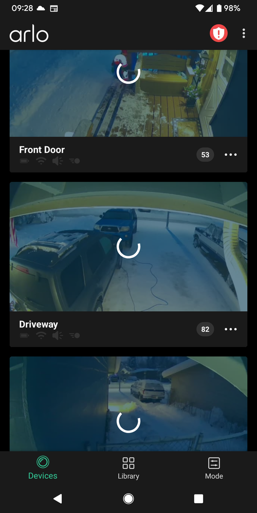

Dec 23rd my Arlo Cameras all reported offline but they are still recording videos. I have tried accessing via the App and the Website. I can view the recorded videos with both the web site and app but I can't open the live view. I have cleared all data in the Arlo App and still having the same issue. I have synced one of the camera's back to the base station but still no good. I delete one camera and tried to add it back but the sync completes but the camera never shows up in the app or my arlo portal.
I have rebooted everything base station, camera and router.
All I get on the web interface and my app are
Your Arlo device appears offline
Please make sure it’s powered on and connected to the Internet.
So I switched browsers just to rule out it being that issue and still same issue. Initially I get the view live recording option then it switches over to cameras offline message.

For the offline issue, you say the removed camera never shows up when syncing again. I assume the offline message is for the remaining camera(s)? In Settings, My Devices, is the base noted as offline? It may be fastest to remove all devices and start fresh.
Attached is the screenshot of what I see from my phone but.
