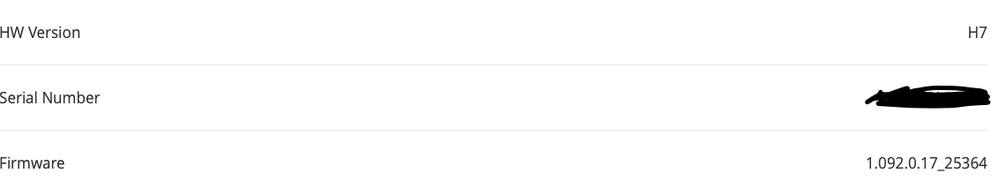

The base station firmware somehow has managed to self update to the current firmware version as of Oct 14, 2018. It must've done it yesterday sometime. However, my cameras are still stuck on firmware version 1.092.0.17_25364. I canot get it to update to the new firmware version.
Here is a screenshot of the firmware for my cameras.
Try restarting the base. If no good, try reinserting camera batteries (just try one first).. If still no good, remove a camera from Settings, My Devices and resync.
