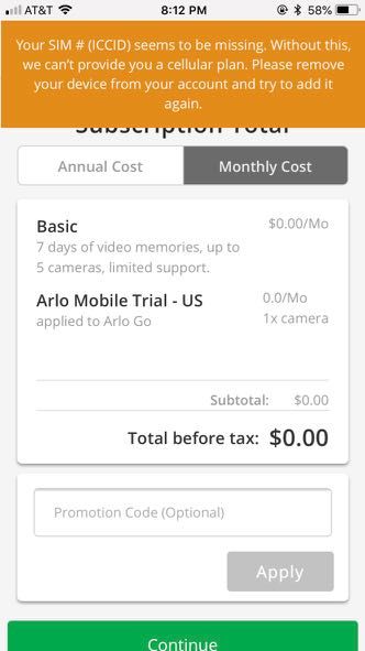

Read my review on Best Buy with the same title above, and you'll see that I have had stunning success with 5 of the original Arlo cameras I installed at our ranch in Texas in a rural area BUT I am having fits with "SIM card not found" on an Arlo Go camera I bought at Best Buy last week, for use at another property having 4 bars of LTE.
Chat was AWOL on the support site, the battery in my iPhone 7 Plus went dead when I called technical support and sat on hold for a very long time.
I tried removing the SIM card and reinserting it, pulled the battery out and reinstalled in, got in my car and drove too two different cell phone towers to be as close to them as I could, using the Arlo app on my iPhone to repeatedly attempt to get the Arlo Go to work (by "add new device") and all I can say this evening is "ARLO is AWOL." )
I assume you purchased a version of the Go that would work with your available cell service? A Verizon version won't work on AT&T.
Yes, when I ordered it at Best Buy, last week I advised that I already had service through AT&T. Opening the battery compartment when it got here, I saw the pre-installed SIM card and assumed I was good to go. The Arlo app on my iPhone shows the Arlo Go as "inactive". Oddly enough, during the attempt to add this to my account, I was able to scan the barcode off my iPhone 7 Plus that was sent to me during the installation process, I heard the "beep" assuming the bar code activated the camera, and still no luck.
I either have a defective SIM card or a defective Arlo Go.
