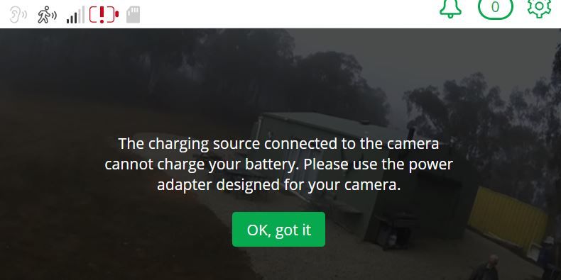

Today I get this message:
I am using the genuine netgear/arlo solar panel.   As you can see it is currently clear and sunny.  The solar panel is facing mostly east to maximize daily sun exposure.  This installation is less than a week old.
I reviewed the solar troubleshooting steps.  I noticed that one step was to verify that the cable was securly snapped into the bottom of the solar panel.  I made sure of that at time of installation.
I may note here that the power cable does not "snap" into place at the camera.  It's secure, its snug, but it doesn't "snap" into place.  I believe this to be a serious design flaw.  I used several zip ties and bailing wire to make sure that critters or wind wont disconnect the power cable.
My installation is 120 miles out.  I'm not planning on visiting the location for another 30 days.
My question is:  What should I consider defective?   The camera?  The battery?  The solar panel?  All of it?
Thank you.

I have the same Issues as above. I  alos TWO new (Arlo Go Mobile HD Security Camera (Bonus - Arlo Solar Panel) form Telstra) Cameras and one of them is doing this constantly.
I removed the battery and repleced it. That worked for a couple of days and now the same issue.
