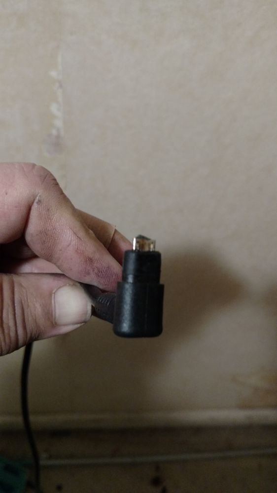

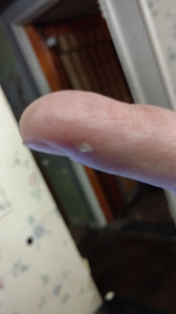

It just gets worse. I drove 1.5 hours to the location to see if I could relocate the camera inside and watch the property entrance from indoors through a window. Guess what It doesn't work. Apparently the Motion sensing will not work through the window. So I relocated the camera back to the original location. Immediately I received an off line error. So I unplugged the power source and received a 3rd degree burn from the power connector while handeling the connector. I looked at it close and it was a complete meltdown along with the connection on the camera itself.
So it looks like Verizon will need to refund all money tomorrow. There is no way they can convince me to continue to use this product. Looking for suggestions for a similar product that WORKS as advertised. If it's possible to give a NEGETIVE 5 STARS I certainly would.

@TMProperties wrote:
Well...
Additional photos comming
Correct.  I believe PIR motion sensors don’t work through modern glass windows, since so many of them are Low-E designs that block IR radiation.  My Arlo Q Plus camera does recognize motion.  I was told that is because it uses the image sensor to detect motion.
With regard to the power cord failure, was that an Arlo outdoor power cord?  Were either the cord or your hands wet?  Wow.  Those are very limited power devices.  I’m surprise it could even generate enough current to have a “meltdown”.  Did you test the outlet to be sure it is wired correctly?  Also, it should be a GFCI.
