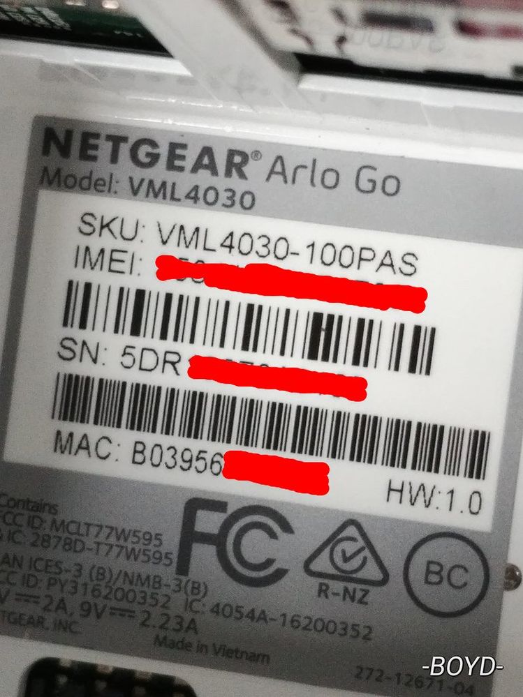

We have the same Arlo Go, VML4030-100PAS purchased at Amazon. The same setup issues. LED will blink blue/purple but end up 'fast blinking orange'.  SIM card is activated and tested working on phone. Any help on this will be much appreciated.  Thanks. PS: Camera is in the Philippines.
