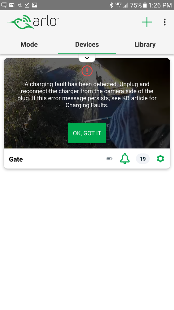

I have had the Arlo Go from Verizon for about a year. Last June I purchased the Solar Panel (VMA4600). It worked well for a long time but now every time I plug the solar panel into the camera I get the error message "a charging fault has been detected." The message goes away when I unplug the solar panel and pull the battery out for a minute before putting it back in. If I plug the solar panel in the message comes back.
The camera works fine when I bring it inside to charge it using the wall plug. I have been now using it outside not plugged into anything without any problems but would love to be able to use the solar panel again. Any ideas on how to fix this?
