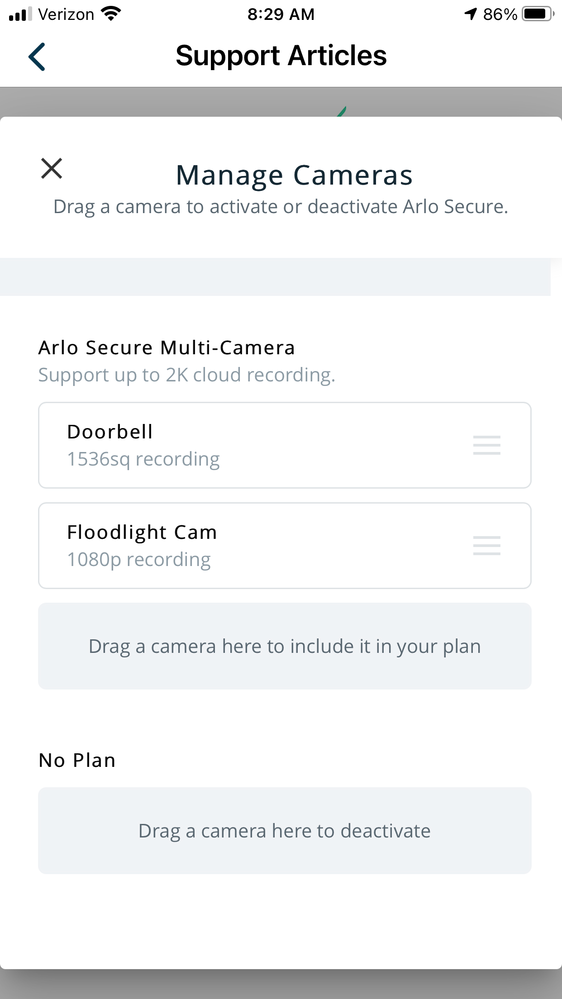

I have an essential wire free floodlight (VMC2030-100NAS) and a wired doorbell. Wired doorbell works great. I can record live and talk through it and it saves recordings to my library. I have the $9.99 a month subscription, but my wireless floodlight camera will not save recordings. It detects motion and tells me, but the spotlight doesn’t turn on when it detects and it doesn’t save the video to the library. It has been reset. It is showing as on the plan. It has a charge and is connected to the same WiFi as my doorbell. How to I get it to record the video so I can view it later?

Unfortunately that isn’t it either; I have had access rights since the beginning. Double checked just in case, but and it shows I have rights.
