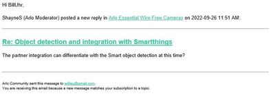

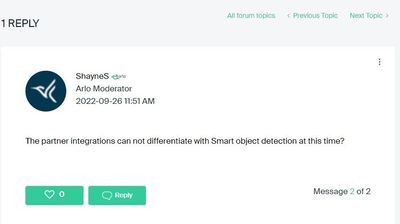

The partner integrations can not differentiate with Smart object detection at this time?
Thanks for the response but it's worth noting the difference between the email message that I received and the message on the website forum. The word "not" can be quite important. 🙂
<Email below>
<Website below>
Can you expand on this?
