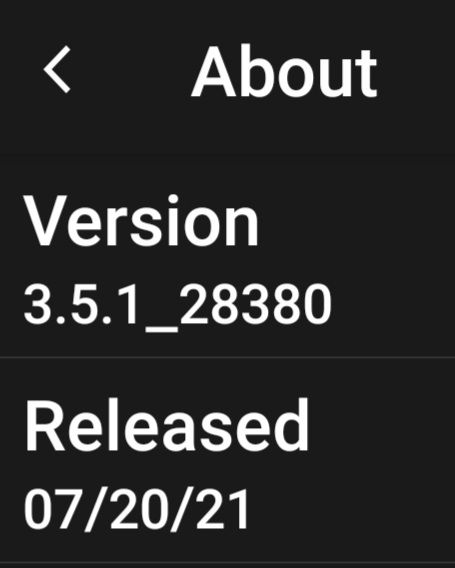

Note there is a bug in the Android app (the 3.5.1 update from 20 July).  It won't show any local recordings at present.   So that might also be the problem (assuming a VMB4540 that has direct access to local storage configured).
billrigsby
By 20 / July I guess you mean July 20th of this year? That seems to be the version I have, I'm not sure what you mean by check the rule of the camera. I have only had Arlos for about a month but the other four function fine. Can you be more specific about the rule of the camera?
StephenB
@billrigsby wrote:
By 20 July I guess you mean July 20th of this year? That seems to be the version I have,
Yes.  Are you using Android or iOS?

Yes, I am on Android.
Are you looking for recordings on the app, or are you putting the USB drive in your PC?
You won't be able to see any local recordings in the app, until Arlo fixes the bug they introduced last week.
