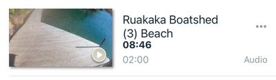

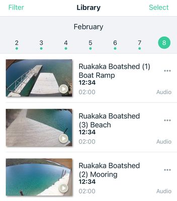

Hi, yes I am. I'd say that between the 4 Arlo Essentials there is a "Sound Detection" every few minutes.
I have an open support ticket, and I'm currently being told that this is not possible as it's not a feature, and that I need to turn down the sensitivity of the motion detection... * sigh *. I guess the bug could be a valid motion detection on 4 cameras, and the alerts are all broken by saying they're "Sound" and "Audio", and not "Motion". However on the video there is not much movement, but loud sounds, suggesting that the trigger was sound.
Either way, something's broken...
Screenshots attached.

Info update from my side.
My 4 Arlo Essentials created 103 “Sound Detection” alerts yesterday!
On one camera I experimented with disabling the mic entirely.
It still generated 18 of the above “audio” alerts, with the mic off…
