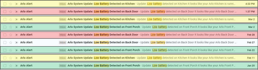

All 3 of my Essential Spotlight cameras have terrible battery life. I have had these in operation for about 4 months and have to charge each camera 3 times. I am now down to them lasting about 2 weeks. This is terrible......

I am not using zones. There are about 40 recordings a day at 20 seconds per.
