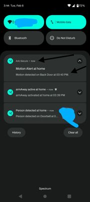

As can be seen in the first of the two screenshots, the current time recorded is 3:44. The arlo notifications marked "now" are timestamped for 3:39 and 3:40 even though the current phone time, or "now" it clearly says that it's 3:44. The notifications marked "now" by the Arlo app are four and five minutes late according to their own timestamp. The phone was on both wifi and mobile data and the notifications were all received on the iPad which was only on the same wifi connection. Also, the doorbell notification had no timestamp even though it was triggered at the same time as the other missed notifications and the doorbell is only connected to wifi and not base station while the cameras are connected to the wifi via base station. In other words, the notification for the doorbell was also 5 minutes late and it doesn't indicate this, in fact it indicates that it was delivered on time and it wasn't.
In the second image it can be seen that sometimes when I open the app I'm given the "you're not connected to the internet" error even though I know I am. All I do when I get this error is pull down on the screen to refresh the page and the error banner goes away and I appear to be back online. Not sure if I'm actuality getting kicked offline, but there's absolutely no reason that should be happening.
After closer inspection today it was confirmed with certainty that during times of missed notifications my phone does in fact have a valid internet connection with a refresh rate of 120Hz. I was able to load YouTube pages and refresh between new YouTube links while Arlo notifications were not working. Other webpages in chrome were also loading just fine on my phone while notifications from Arlo were delayed/missed.
