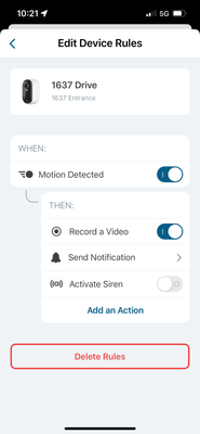

One other point to make here is that it’s inconsistent. I can walk past, drive slowly past, get a notification, but no video.
Screenshots below.
If this is solvable, I’d be a lot happier!
