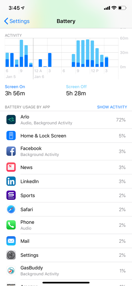

AsheM
I just purchased the Arlo baby. Yesterday. My wife has the iPhone 10 and I have the iPhone XR. The Arlo app is currently utilizing 72% of both our battery usage. My battery life has been reduced to half of what it was prior to adding baby Arlo. If anyone has recommendations on how to preserve the battery life, would be great to hear. Otherwise we are going to have to send this back and just buy a non-WiFi baby monitor.
