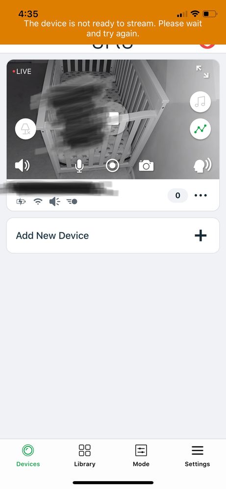

When I try to take a picture or manual video lately, I get this orange message at the top. Can anyone explain why it’s saying this please?
Hi Mrsbacon,
Have you tried rebooting your iPhone device to see if that helps? Also try reinstalling the Arlo app if you're seeing that error.

Also when I’m at home and it’s working on the home network, I’ve noticed when I try to manually capture a photo or video, I get an error stating “this device is not ready to stream”. I’ve been able to resolve the issues by manually unplugging and repluggjng the Arlo, however the issues pop up again soon after.
