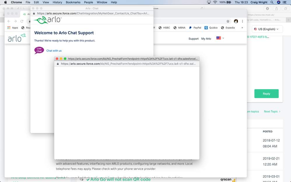

Does the software team for arlo also work on the website too? The chat function never works using any browser on Windows or Mac!

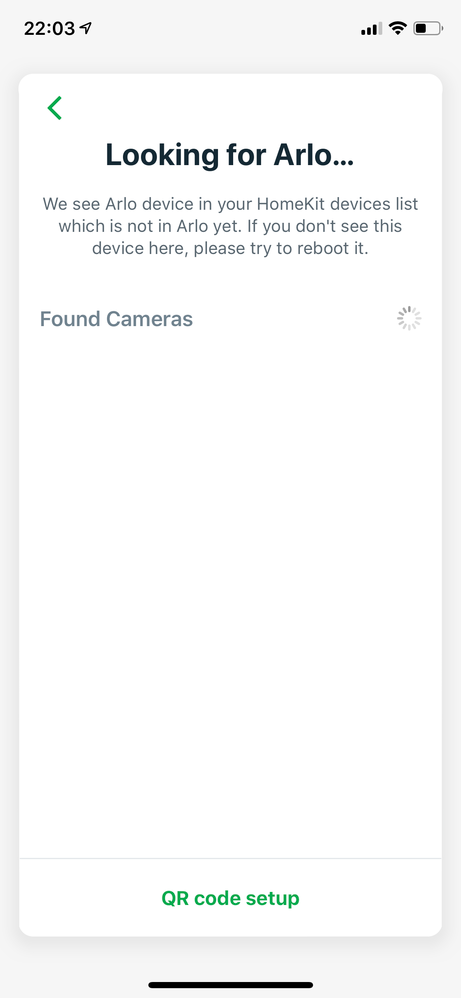

I am having this issue. My camera was working fine and just disconnected. I have done EVERYTHING, including setting iPhone to factory settings. I cant get past where it claims that, "we see Arlo device in your HomeKit devices list..."
How is that possible?!?!?!? QR code isnt working.
